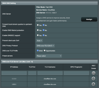

I had this on AX88U. Now it's back on BE88U. I'm using Cloudflare with DoT enabled.
I think I gave up on this the last time (on AX88U) and pretty much used ISP defaults eventually.
What's interesting is that it's very specific, like https://www.swedbank.se (all clients affected, homepage or phone apps), but I doubt it's the only one.
The quick fix is to simply restart "internet connection" in scMerlin. But if going by the history this would not last for many hours or with some luck some days.
Can the setup someone be bad/incompatible with my ISP or something?
What can I do to trial and error this behavior?
What can possibly be wrong here? It seems impossible that this part alone to be badly configured, right?

Your setup is correct. Could also be Cloudflare anycast (they have had issues lately)
