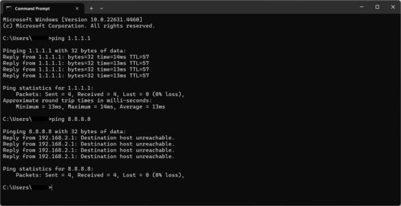

Yes. What happens is the requests to 8.8.8.8 and 8.8.4.4 should go no where (time out / be unreachable) when configured with the router's IP in the gateway field/drop down box.
Edit to add: Example ping from Windows PC showing 8.8.8.8 is unreachable attached.
