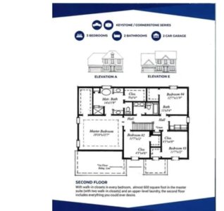

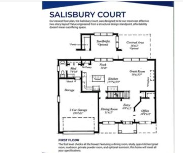

Attaching pics of my house.

Site is picky about uploading pictures, think I got it now. There are 8 ports on the dead switch.
There are 2 x Ethernet jacks in the office, one in the kitchen, one over the fireplace on the first floor.
one in each of the bedrooms upstairs.
