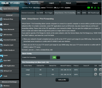

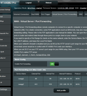

Are you trying to forward http and https to a second device? Are you sure the external/Internal ports are correct?
Absolutely I am using swagg on my nas and they are the ports I have to open as soon I switch with the old RT AX86U everything is back
