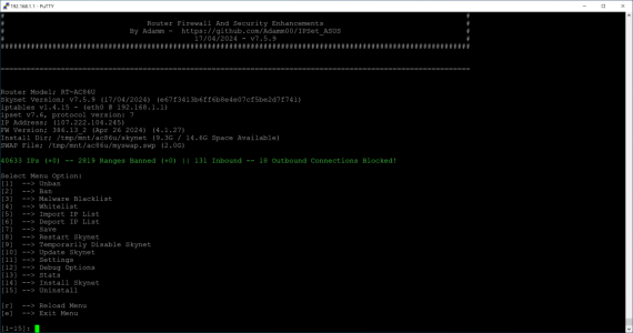

Why did Skynet checksum change - the version stated the same, 7.5.9. See the 2 screenshots.
I am running an older dnsmasq (2.89) on top of the latest FW trying to sort out some issues, but I would not think it matters?
