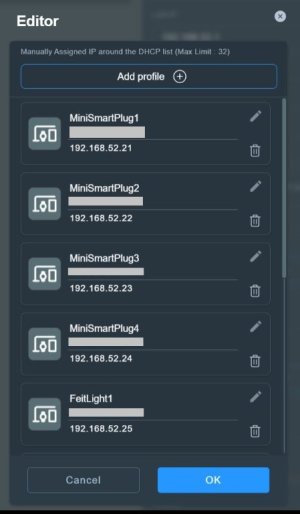

For completeness, also to advise if they still have any Manually Assigned DHCPs (max 32) in the Advanced Settings menu of their Guest Network Pro profile. These should be deleted so the count reverts to zero.
This is also a potential source of conflict and for me, caused (when I was using them which I no longer do) my dnsmasq-index.conf.add file to fail. Note that YazDHCP adds a one line entry to each GNP instance of that file, each of which refers to a list of the actual YazDHCP MAC:IP:HOSTNAME entries (.staticlist, .staticlist_br52, .staticlist_br53 etc under the YazDHCP Addons dir /jffs/addons/YazDHCP,d/.).
Its threads like this that make this community awesome. I've become comfortable with how GNP works, the nvram variables it uses, how it's different from the 388 codebase, which I used to use the dnsmasq.add method for my IoT devices and the old GN1 that was replicated to mesh nodes.
I'm sitting on a couple boxes of KASA smart switches and I'm at 20 of the 32 manual GNP reservations, so I'm approaching the need for a new method. YazDHCP sounds nice, moving the GNP reservations back to the main LAN/DHCP Setting. Appreciate the extra insight.
