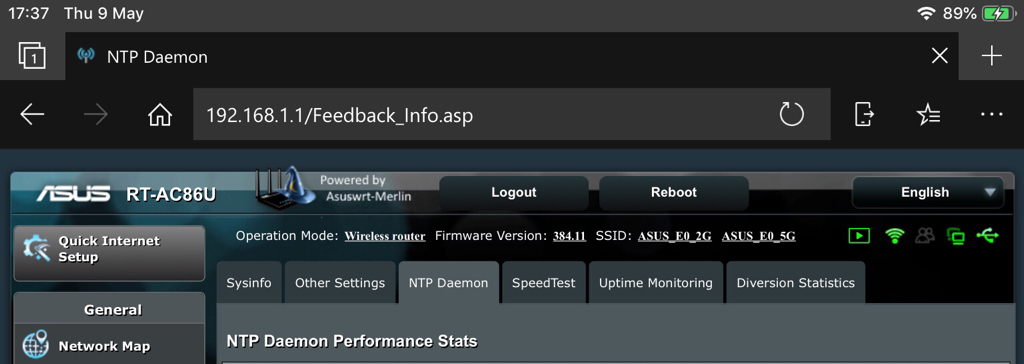

Just an observation and apologies if this has been addressed already. The address bar reads /feedback_info.asp
Speed test screen is similar

Yup, that's expected as I'm overriding existing pages rather than use my own and have the user have to clone /www
Thanks for taking the time to explain the reason [emoji3]
