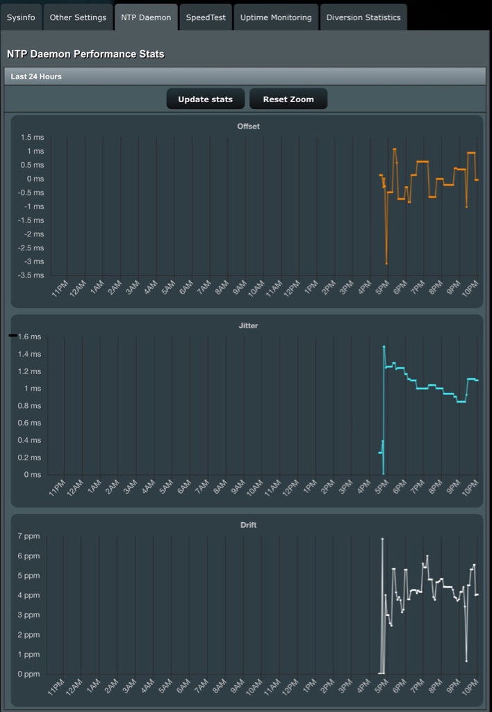

All done [emoji106]
I didn’t see any errors updating and new stats are appearing [emoji4]

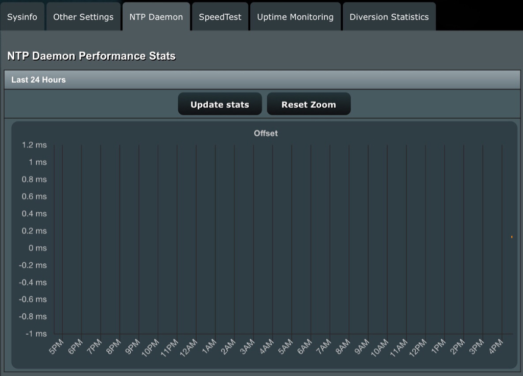

Did a completely clean install. I had recently done a full reset on my AX88U. Entware was installed after.
I downloaded just the script (no install), changed line 24 to "develop".
Then did the ntpmerlin install. I did get an error for what it's worth:
ERROR: opening '/jffs/scripts/ntpmerlin.d/ntpdstats_rrd.rrd': No such file or directory
cru has the correct ntpmerlin generate line and the Tools page does have the new NTP Daemon tab.
I tried a manual ntpmerlin generate.
Got the same error message and it appears my graph is completely blank.

Could you clarify which option you used for install? there's no reference to rrd in the current develop branch
EDIT: ah - what you did won't work. The script will still be using "master"'s code when you tried to install, but since you had changed the branch, it will have tried (and failed) to download files from the develop branch that don't exist. Download the script from develop instead
Thanks, I did as you requested. No errors on install. I will give it a few hours
v2.0.0 on RT-AC86U. Smooth update, thank you [emoji106]
