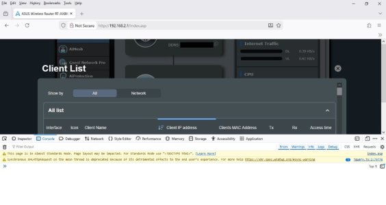

I began noticing this issue several firmware updates ago. I run 2 Asus routers. My main router is an RT-BE88U and #2 is an RT-AX88U Pro running in AP mode. Currently running the latest firmware...3006.102.5. What I am seeing is after logging in to the Router I go to "View List" of connected clients from the Network Map page. I can see all the connected hardware listed. In my case the list scrolls off the bottom so I have to scroll down to continue to view. However after I scroll down the page it will do like a "refresh" or something and scroll back to the top again meaning I can no longer view or edit items lower down on the list. It used to not do this scrolling back to the top. It does this with both routers.
Both routers seem to be working fine so, at least to me, this appears some kind of GUI glitch.
What web browser are you using?
Have you tried a different web browser as a troubleshooting step?
It may help the developer if you can show a screen shot of what you are experiencing.
And check and post any error messages listed on the "Browser Console" window when you experience the issue. (Press the <F12> key to open the "Browser Console").
I was going to reply back and suggest this wasn't a Browser issue but then......Boom! I decided to try in Edge and the issue does not appear. I use Firefox. Current version is 144.0 but as mentioned this has been happening a while for me. I tried Firefox in Safe Mode and the issue still occurs so this appears to be an issue when using Firefox but not Edge. I guess I need to try this using multiple systems here to see how much it is duplicated on various hardware/software combinations.
