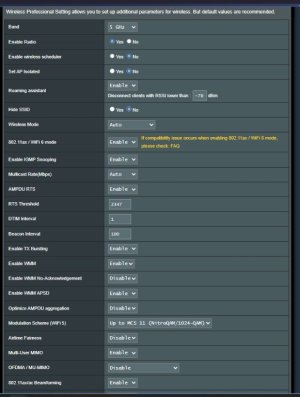

Hmmm, interesting. OOC I checked my RT-AX88U Pro Wireless, Professional Tab and cannot see any 11b setting. Odd that this old tech has appeared on a much newer Router generation, but not on the older one, unless it is somewhere else ... or called something obscure that I missed...
You obviously won't find anything 802.11b related on 5GHz band.
