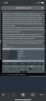

I'm trying to Port Forward 44158 on my RT-AC88U. However, when I try any kind of scanning tool, it says that 44158 is closed or can not be reached. Any ideas what could be going on? I believe I have it correct on the router side(see image). I have also disabled UPnP. Thanks in advance.

Your image is too small to read.

@ColinTaylor, sorry about the image. See new image.

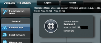

Can you confirm your earlier statement regarding the router's WAN IP address shown at Network Map > Internet status > WAN IP address.
OK. So what is the internet gateway device? If this device is just a modem, or a router/modem that can be "bridged", it may be able to provide a public IP address to your RT-AC88U.
Attached are images of both the gateway and WAN IP. I'm not sure exactly what the gateway does, it might be a simple modem.

From your router's WAN IP address the gateway appears to be acting as a router. I don't know whether you can log into the gateway and change some of it's settings (port forwarding, DMZ, or bridged connection). If you can't then you won't be able to fix your original problem.

Right now I’m working to try and get a public IP from my ISP. I think that’s the issue. Hopefully should hear back from the ISP soon.
Please update your RT-AC88U firmware. Based on the screenshot you provided, your firmware version 3.0.0.4.380* is from early 2018 which contains exploits. You can choose either one of the following which were both released today:
