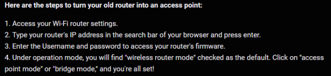

The above article goes on if your router does not have "AP Mode" the forcing to AP, involves DHCP off & assigning router #2 diff IP address

It seems Netgear forgot to include an AP mode setup page in their web interface. For a basic manual setup you need to do two things to router #2:
-setup a static LAN address. Go to ADVANCED> Setup > LAN Setup and change it to something like 192.168.1.2. Click Apply.
-disable the DHCP server in router #2. Go to ADVANCED> Setup > LAN Setup and untick "Use Router as DHCP Server". Click Apply.
Then connect router #2 to you LAN. At this point it should be able to connect to the Internet and wireless should be working; but you might want to configure further details like channels, SSID and passwords if you have not done this already.
