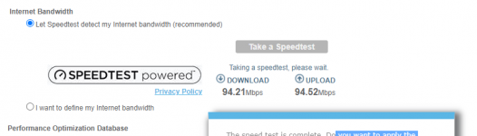

Ok, there is a speedtest from within the router itself on the web GUI. You tried [laptop]<—LAN—>[R7800]<—WAN—>[MODEM], but not within the R7800.
The purpose is to eliminate the hypothesis that the bottleneck is in between LAN and WAN routing in the router.
Maybe another test with trying: R7800 in bridge mode.
Results attached. I'll try the access point when I get a chance.
