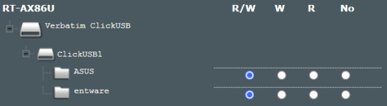

You could share the entware directory on the USB drive via the router's Samba or FTP and access the files that way.
