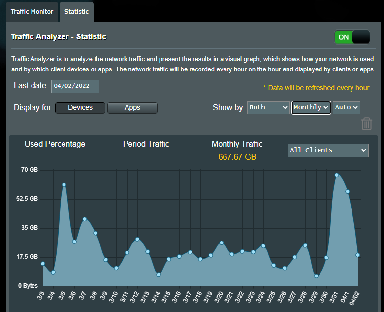

So if you change the "Last date:" field to 16th March on the monthly Traffic Analyzer graph what does it look like?
Using sqllite to do a SELECT * FROM traffic shows that there is indeed no data prior to 3/1/2022 00:00.
