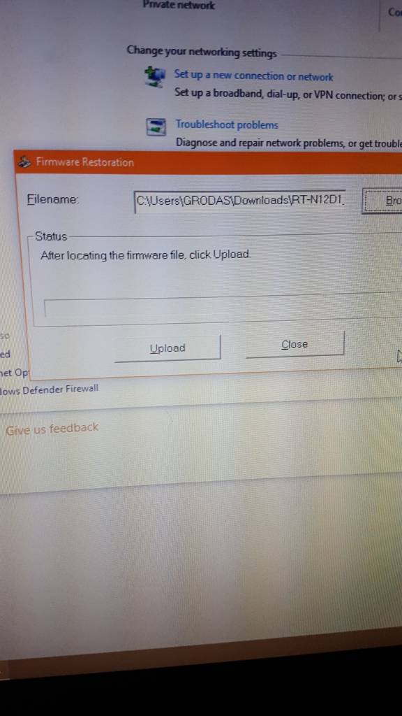

Once I put the router in rescue mode it no longer creates a wifi network. I connected via ethernet but the firmware restoration tool doesn't find any wireless router available. I was able to connect to the router through the browser. It actually had a rescue page and an option to upload a new firmware. I did that but it still didn't do anything. I'm not sure what else to try.

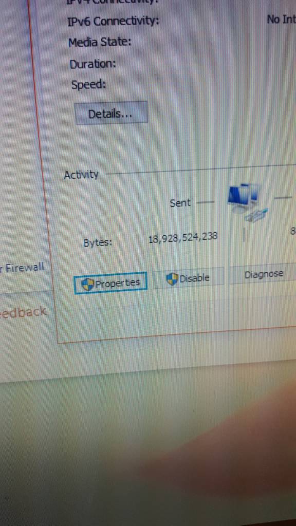

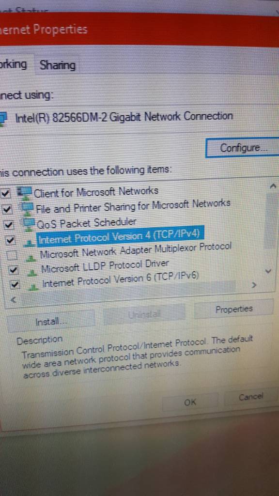

Before doing a rescue mode set a static ip addres to your computer of 192.168.1.2 subnet automatically will fill default gateway 192.168.1.1
Sent from my SAMSUNG-SM-G920AZ using Tapatalk
Like that once you do this then proceeded with rescue mode once in rescue mode it will upload firmware
make sure you use admin mode for the recovery tool
