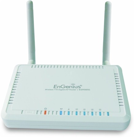

EnGenius 300Mbps Wireless N Router with Gigabit Switch (ESR9850)

*notes: check the smallnetbuilder review link especially because it shows the performance chart which shows the EnGenius performing very well especially max simultaneous connections which makes it awesome for p2p.
WAN to LAN: 619.3 Mbps
LAN to WAN: 640.0 Mbps
Total Throughput: 740.3 Mbps
Maximum simultaneous connections: 19,721

Why don't you downgrade the firmware in the DIR-655 with the Russian one that will allow you to install firmware 1.11 or 1.21. As for ESR-9850 with firmware 1.09 everything works well wireless does. I'll be running some test today using both as AP not router and AP. ESR-9850 good if you plan not to use VPN. The other router you have here listed you should really go to the forum where this router is supported. I was gamed myself on it until reading the issue good number were having with it.
So either downgrade the firmware on DIR-655 or find ESR-9850 with firmware 1.09 on it. Those max connections don't get to caught up in that though. Other choices are Belkin N+ V1 though not V2 or TEW-673GRU is really quick 680MHz wireless is very good if you have it on the on the main and second floor coverage is very good not so go if you have 3 floors.

Oh okay I see your point with the DIR-655 A2 1.11. Time to move on then. DD-WRT unless you can get WRT-310n which works perfect with that firmware. EnGenius ESR-9850 is really quick routing, and P2P downloads are steady. There is ESR-9855 out cost more has 475MHz 64MB of RAM don't know what the max connections for that one is though. Not tested yet on this site. I didn't want to go for it. TEW-673GRU is a keeper for me as a main router is blazing quick on routing. Haven't seen anything to cry home about as they say except for the wireless signal. I only seem a few wireless routers that can blanket the house here is coverage without the use of extra AP.
So the choices are:
ESR-9855 no dual band
ESR-9850 no dual band
TEW-673GRU with LCD and dual band

No the videos won't show your that. I can test the last one and show numbers. Just have to rig it up. I should really see how it does. P2P was going so quick the other night steady stream 3.xxmb/s down. WAN to LAN / LAN to WAN I leave that for P2P stuff LAN to LAN is over 150mb/s over wired gig. Wireless I'll need to test that also.
Just got two ESR-9850 re-flash to 1.09 firmware configure them as AP on different network type/modes 802.11g and 802.11n (got to disable a lot to get them to work in AP) and daisy chained them also.

I don't have so many AP in operation. One should be able to cover the house. But the TX mW on these routers is set to low. I need about 70mW to cover this house from top to bottom and 360 degree radius with 300 ft span outside.
Where I have the two right now they can blanket the house with a strong signal. ESR-9850 wireless drops off the radar I got pictures showing it on and off side by-side crazy. Even if they're watching this forum, still issues with the ESR-9850 firmware or not. ESR-9855 I didn't want to waste money on a product that might not deliver.
