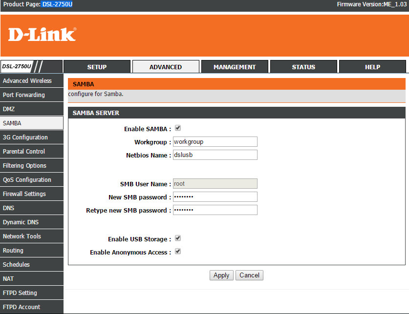

Hello, I attached a USB 3.0 drive to my d-link DSL-2750U router. Enabled SAMBA page in the router settings.
But when I try to connect from Windows 10: \\192.168.1.1
Windows tells me:
"The device or resource (192.168.1.1) is not set up to accept connections on
port "The File and printer sharing (SMB)"."
I uploading pdf print out of windows error.
What could be wrong?

Hello,
The Windows diagnostic says:
Is there something in the router settings that could prevent it from accepting connections from Windows? Any help would be appreciated. There are posts elsewhere that seem to indicate people were able to get USB drive sharing work well with this particular d-link router.

There may be some more configuration required or the drive format/size may not be supported. We need some more information on the drive you're trying to connect.

It's an auth issue between Windows and the version of Samba running on the device...
The preferred way is to fix samba itself, but the client workaround as pointed out by John9527 also works...
