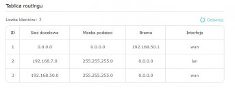

Below are TP-LINK routing settings

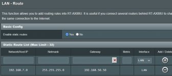

The TPLink needs to have a fixed address on your 192.168.50.0 network - set this up as a static entry in your Asus's DHCP table.
Then you need a routing entry on the Asus router "192.168.7.0 255.255.255.0 192.168.50.xxx", where xxx is the fixed address of the TPLink.
Unfortunately, you still don't see anything in the address 192.168.7.xxx

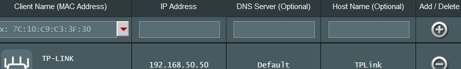

TPLink has the address 192.168.50.50
