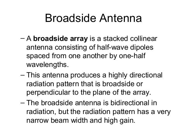

i think there's also a certain degree of physics behind the antennas' position. the ideal placement should be 45 degrees for all 8 antennas. reason being if you place them 90 degrees straight up, the signals from the 8 antennas will cancel out each other circumferentially. this results in a lower coverage and slower speed at long distance.
if you position them 45 degrees, the signal will have much less interference from each other as all are dipolar in nature.
its the design of the router which forces the consumers to place at 45 degrees, while other designs such as netgear r8500 and maybe asus ac3200 do not compel users to do that..
i think the new beam forming over rides the specifics of antenna orientation due to how beam forming works as you can put the antennas in any position and then the beam forming takes over and figures out where the clients are after that
you move the antennas again and beam forming then re calculates , its actually quite noticeable if you turn off beam forming as then the antenna orientation is far more noticeable by the client , with beam forming enabled its far less noticeable
That makes the assumption that
1) All of the antennas are fed identical signals, and
2) They are an odd number of half-wavelengths apart.
You will find that neither is true.
The phase of the signal will also make a difference. Two in-phase signals will add, not cancel each other, regardless of the antennas positions.
Sent from my Nexus 9 using Tapatalk
Indeed it does--which is why two antennas fed the same RF signal, but a half-wave (180°) apart, would cancel in one direction but add at right angles to that.

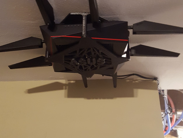

I am mounting my RT-AC5300 on the wall (horizontally) with this mount: https://www.thingiverse.com/thing:1479112
Regarding signal / antenna orientation... I assume a ceiling mount is very similar to routine RT-AC5300 usage, where it would rest on a flat surface. (However, the signal is about 4-8ft higher than it would be on a table.)
Regarding wall mount... what is the impact on the signal with respect to antenna orientation? Should 4 point straight up, and 4 straight down, or should all 4 be in plane with the base of the unit (as in this photo: https://cdn.thingiverse.com/renders...361d7c11ffdab3f122e204_preview_featured.jpg)?
Ceiling Mount Image:
