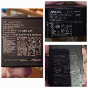

I read in one of the forums that the plug is very specific to the router in terms of the input and output. In my picture all are asus plugs but with different specifications. My newer routers don't even have ASUS written on them. That's how I ended up here, while troubleshooting my plugs got mismatched from the routers and all have the same plug size. I wanted to match the correct plug and router. Any idea if this is correct info?

@kengell You haven't said what routers you have so we have no idea what power adapters they might use.
Go to Asus' website and look at the Tech Specs for your router. It will list the power requirements although not the plug size.
Which adapter goes with what router?
Try looking at the tag on the router!
