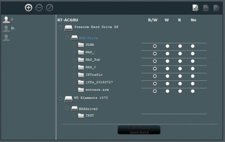

The drive now shows up. The transfer speeds are still max 25-29Mb/s ... :(
But the other issue is still there. I rebooted the router. Now I can't change the share permissions anymore. It was possible to do so until the reboot. o_O
