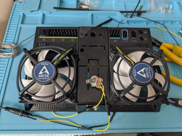

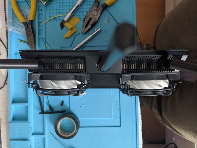

I want to contribute images of my project.
In addition to adding the ventilation as seen in the images, I changed the thermal pads for new ones in the CPU, and removed them and exchanged for thermal paste in the chips that handle the wireless connections and in the memory pads. I also straightened the disiators, which had folded (because of the heat, I suppose)
Temperatures have dropped from 44º - 55º - 85º to 37º - 42º - 53º (± 3º)
