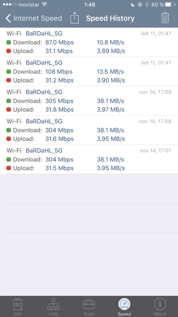

Hello,
First at all sorry about my bad english and thank you very much for your firmwares...
Recently i purchased a new 88U (i had before 87U) and as always the frst thing i did was flashing your fw.
At this moment everything is working fine for me except for one:

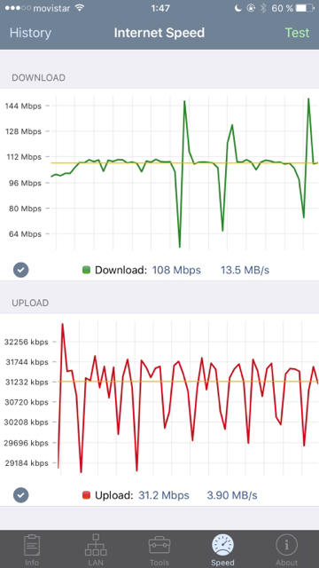

All the smartphones on my house are APPLE my own is iphone 6S Plus wich i connect to the 5ghz wifi, whit this phone i had excellent wifi speed whit the 87U, my ftth is 300/30Mb, but now whit the 88U i cant reach even 150Mbs of download and the conex is very unstable (many peaks).
Is there anything i can do to fix this??? i leave a screenshot of my history speedtests so u can see my last speedtests whit 87U and the new ones whit 88U (same phone, same ftth, same place and even at the side of the router)...
In this capture u can see the peaks:
In this capture u can see the history:
Thanks in advance

Looks like you're having some wireless packet collisions. On the wireless settings, professional tab, lower your RTS threshold to 2305 for starters, then retest. (You will need to do this for each band)

Hello Puppa and thanks you for your answer, after setting this RTS threshold on both bands the speed dropped very hard even for upload and get worst :(
I leave a couple of carptures... Any other idea?
