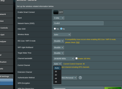

Also note that on 5GHz you will get higher power output if you select a fixed channel between 100 and 140. I suggest trying channel 100. You're currently using channel 36.
cant change to 100 because only have that cannels

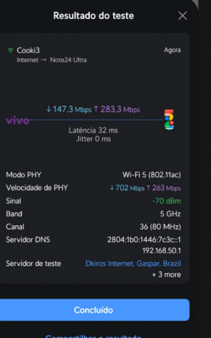

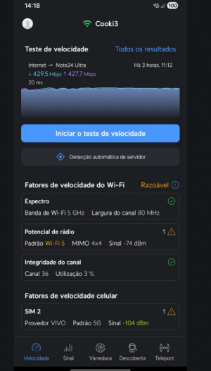

As you said, -70 dBm is far too weak. I would expect something like -40 dBm or better.
Is the 2.4 GHz channel equally weak?
Good evening. I have an Asus RTAX86U router purchased in Portugal where the Wi-Fi worked perfectly. After moving to Brazil, the Wi-Fi signal lost strength; I can only connect my devices if I'm within 1 to 2 meters of the router. What could be the reason for this? Is there some kind of wireless restriction due to changing countries? Could malware be causing this on the router? I've already tried several Asus and Merlin firmwares, and nothing changes. Currently, I'm using firmware 3004.388.11. @ColinTaylor Can you give an opinion? tks
