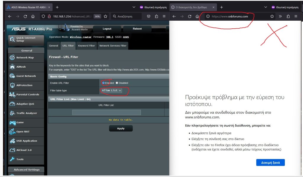

Firewall -> URL Filter -> Filter table type = ALLOW LIST
when Enable URL Filter
i have no internet to url sites for all devcices (lan & wlan) but i have access if i type directly the server's ip

This is a general problem with "Allow Lists"
that whenever I activate it the entire network stops accessing the internet
if i select "Deny List" it seems to work correctly :rolleyes:
the problem still persists even if i add some rules

same with network services filter
That's exactly what it's meant to do.
You've told it that you want to block all internet access other than those destinations in the list. And because your list is empty you have no internet at all.
I thought lists work differently. I was wrong...
