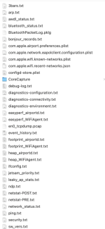

I have looked extensively on my macbook but cannot find where the DFS State is listed. It's not on the same log page as that other information. When I run a full wireless diagnostic, a folder is created with 50 or so files. I'm attaching screenshots of those files- is there one that would contain DFS information?

DFS state is on the log page of the router not your macstuff.
If DFS is not idle this can cut speed by half, if not more.
Its on the same router page where you find noise and speed values.
