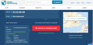

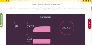

Speednet 5:21am this morning, back on my RTAC86U
The speed is great considering my ISP gives 200 Mpbs, last night on another NordVpn it was 276 Mpbs

Virgin Media
