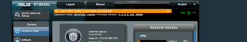

new router running this firmware will not upgrade to merlin 102.5 even with the downgrade hack.. doesnt give any error just reboots to the same firmware
any ideas before i return it.

granted .. unfortunately i didnt look that close as i ordered a 88u and exptected that is what i was sent.. so of course a firmware update would not take.. lol.. sent it back.. thats what i get for getting an open box one at a 100 discount.
