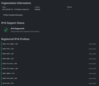

This is exactly what I have. My clients gain a IPv6 “2001” but they can’t ping ipv6.google.com
You mean set the ipv6if to „eth“ via ssh, could work?
