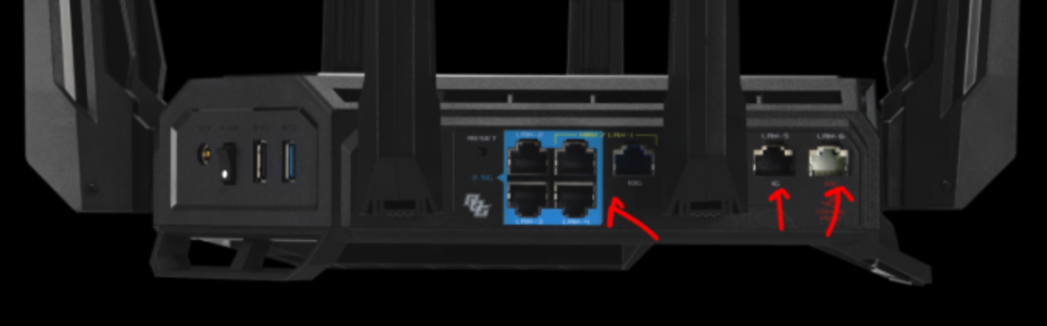

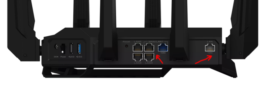

it is not the same. BE190000 has 2.5GB LAN ports and has 1 additional 10GB port compare to BE96U
It's its own router, with its own firmware.
