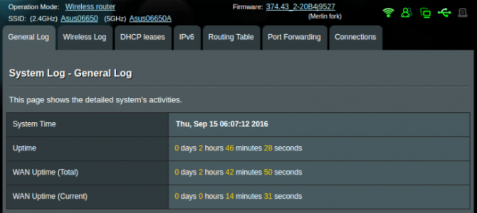

Please see here: https://www.snbforums.com/threads/wan-uptime.8570/post-280676
I want scmerlin will have wan uptime counter like this.

WAN uptime was a feature of John’s fork.
Another attempt:
This guy has been at it for years:
Ah I see the difference now. One exclusively tracks the WAN interface while the other is just the regular system uptime. And he's looking for WAN uptime not system uptime.

Understanding he wants the WAN interface helps, but I'm still not sure i see the reason why this is a requirement. I guess for people that have less stable WAN connections the goal would be to see if you recently had a drop? Is that correct?
My bad I have been watching this request silently without giving any opinion or interacting with it. Now, here's my support for the idea.
Ah I see the difference now. One exclusively tracks the WAN interface while the other is just regular the system uptime. And he's looking for WAN uptime not system uptime.
Yeah, this is exactly what he wanted since the beginning but it seems he didn't explain it well, maybe due to language barriers.

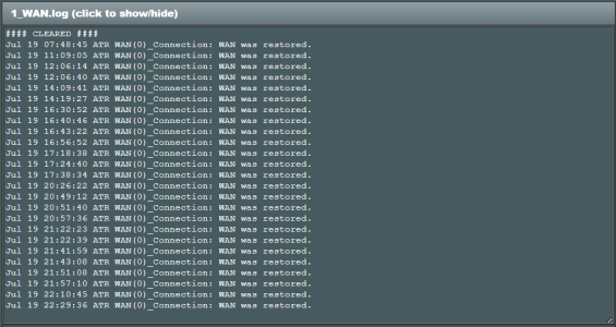

Exactly, you just thought of the exact need for this counter. It's a good addition for less stable WAN connections, and a necessity for DSL connections like mine, as I'm still unable to upgrade and now stuck with a 1 Mbps connection, and having tens of downtime incidents every day!!!
A while ago, we discussed the possiblity of deprecating the dn-vnstat script, and I gave my opinion that it is still relevant for so many users in poor countries around the world. Now, here it applies again for poorer countries with unstable internet connections (including ADSL such as mine).
Yes, it is very useful to me to have such a counter. Moreover, it is an official feature in ASUS DSL-****U routers, and I had it in my DSL-AC68U router (gnuton fork) before I had to exclude it from my home network due to extreme line noise, as it have a lower-end CPU.
Since I excluded my ASUS DSL router, I exclusively depend on my filtered logs on my RT-AC68U to check when was the last downtime, as my TP-Link ADSL router doesn't have such a counter. Attached is a screenshot of just a glimpse of my daily disastrous struggle.
