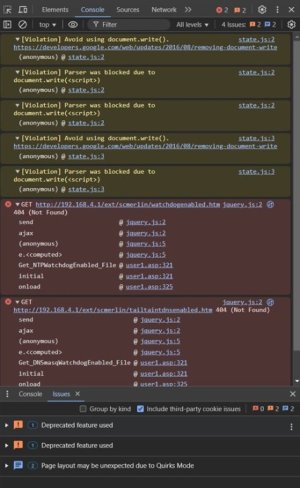

Can one of you (or both) post a clear screenshot showing any error messages that may appear on the "Browser Console" window?

Clicking scMerlin tab:
Clicking Sitemap tab (no error, what you see only shows because I have verbose enabled);
I'm not seeing any errors - just warnings
Sitemap tab:
scMerlin tab:
Yup, that's what I meant with "no error, what you see only shows because I have verbose enabled". If verbose is off in the console, there is nothing at all (on the sitemap tab).
You use chrome/edge and can see mention of javascript. I tried chrome and got the exact same warnings.
But in my normal browser (firefox) the messages are totally different. I have ensured javascript is enabled in both firefox and chrome.
