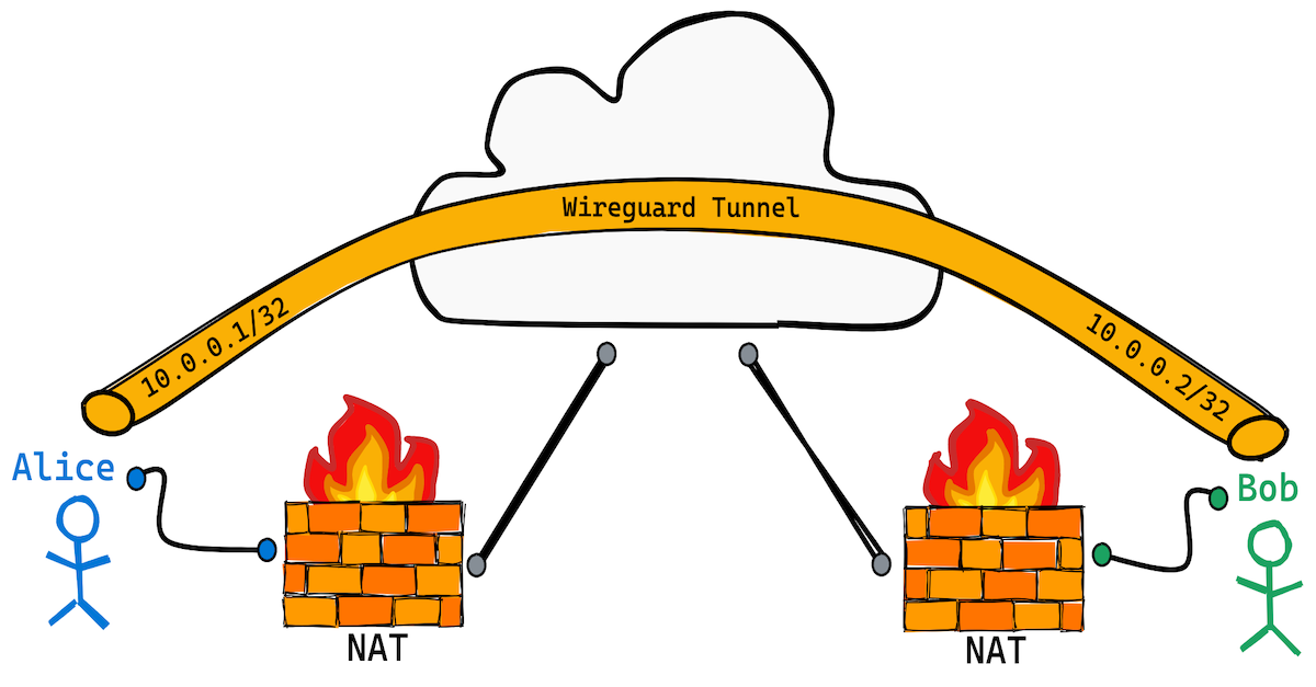

While I don't have ListenPort in wg11.conf, I noticed there is listening port from wg show wg11 listen-port output.
Without really knowing I would say that this is the peer recieve port. The .conf normally only gives the endpoint (destination) port and the kernel will assign an arbitrary recieve port.
Guess the listenport directive would try to force the peer to a specific recieve port and may even be used by the wg software to open this port in the firewall.
The wireguard interface does not have any client or server knowledge and is designed to function as fully bidirectional. As such interface both source and destination ports need to be agreed upon.
It actually seems as, because of wg double roaming capability, and udp nat hole punching this could actually work, bidirectional even behind cgnats (as long as you can make the initial connection).

Fascinating work to illustrate Wireguard possibility to utilize udp nat hole punching allowing 2 clients each behind cgnats to connect to each other via an relay server (only for the initial connection, not hub-and-spoke).
