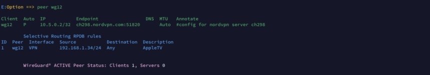

Now I have also changed the peer to P=Policy, however, now all my LAN devices e.g. iPhone or iMac are still going through the Wireguard VPN client connection.. but I only want my AppleTV to do so. Have I forgotten anything?
Check how your rule actually turned out in wgm:
E:Option ==> peer wg12
Perhaps still some typo when you entered the command. Or perhaps some earlier attemp not deleted?

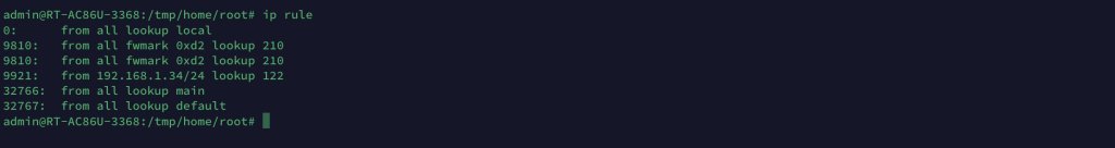

you could also check how the routing rules turned out (not in wgm)
ip rule
ip rule
Peer wg12 result:D285D4BF-EF13-4A10-AA76-67BBC0476493.jpeg
ip rule result
