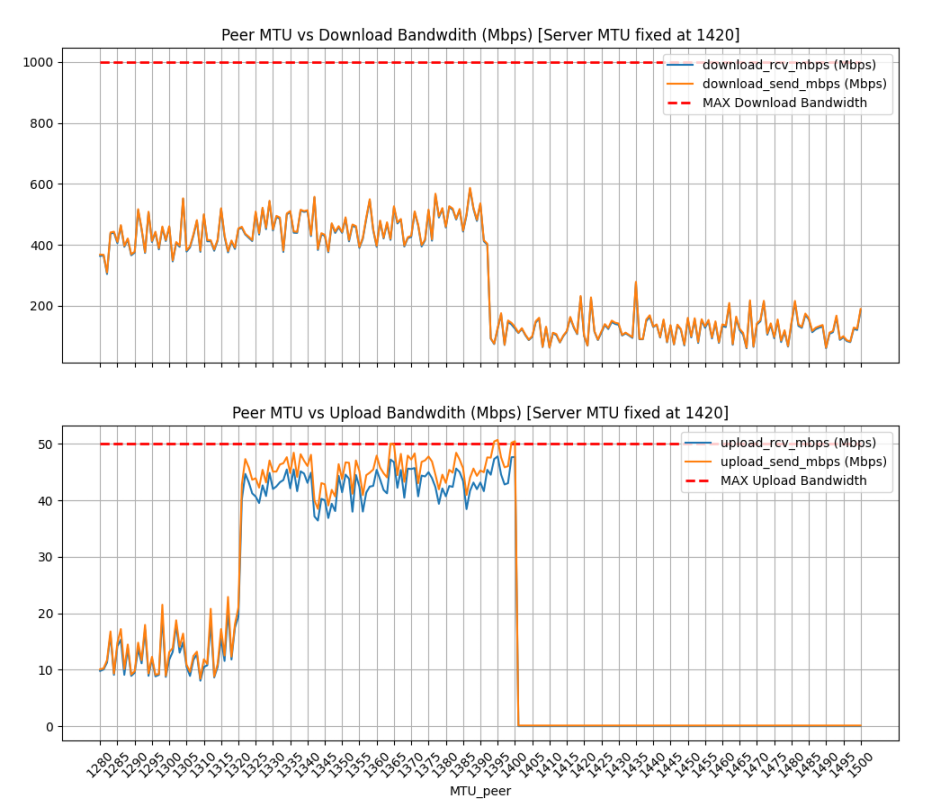

  • CHANGE: WireGuard® now determines/sets the 'client' Peer MTU rather than being explicitly set to 1420.
i.e. Running a debug, shows that wireguard_manager Beta v17b2 no longer explicitly executes ifconfig mtu 1420 for wg11; but explicitly issues ifconfig mtu 1292 for wg14 because TorGuard includes MTU = 1292 in its generated imported profile.

[ ] Auto MTU:1420 determined by WireGuard®
[#] ifconfig wg11 txqueuelen 1000

[#] ifconfig wg14 mtu 1292
[#] ifconfig wg14 txqueuelen 1000
<snip>
Now this probably shouldn't break anything (default 1420 is still applied), but may assist those with PPoE/IPv6 connections where 1420 is inappropriate.
e.g. The default 1420 works fine for my Mullvad connections

and in a pure FTTH IPv4 environment I can increase this manually to 1440 and it still works - see wg13 although not sure of tangible performance increase.
So it will be interesting to see if WireGuard® can indeed actually intelligently determine the optimal MTU in say Dual-stack environments e.g 1432/1412/1280 or if I may need to modify wireguard_manager to intelligently compute (and explicitly apply) an appropriate MTU.
@ZebMcKayhan - For your environment, did you intuitively know that you must override MTU 1420 with 1412?
Uuh, not really.... it was something I read like 1,5 years ago. I guess it comes from 1420-8. It has just always worked for me.
I've never seen any Performance gain/loss when changing this but then I'm only on a 100/100 line...
OK thanks.
I was going to assume it was derived as follows:
  • If WAN Fibre MTU 1500 then 1440 (-60) for IPv4 and 1420 (-80) for IPv6
  • if WAN PPoE MTU 1492 then 1432 (-60) for IPv4 and 1412 (-80) for IPv6

OK thanks.
Not looked at MTU for years so some basic questions
My internet connection is VDSL and uses DHCP Option 61 rather then PPPoE and
in the Router WAN MTU it is currently set at 1500 (which is the default recommended by ISP)
checking with ifconfig br0: 1500, wg11: 1420 & wg21:1420
Checking the max fragment size for IPv4 not using the VPN (ping -4 -c 5 -M do -s nnnn <site>) I get 1472, reducing to 1452 for IPv6
Testing on wg11 clients these reduce to 1392 (IPv4) and 1372 (IPv6)
Testing on wg21 (from my phone) to the LAN address using Ping tools, size set 1252 (reported 1260) for IPv4, 1232 (reported 1240) for IPv6
Questions
  • do I need to adjust the MTU in WAN > MTU or is packet size handled automatically by router?
  • do I need to adjust the MTU settings on wg11, wg21 and/or any devices and if so how?
  • how can I test if this makes any practical difference?
Ping ipv4 has 20 bytes ip header and 8 bytes icmp header. For payload of 1472 + 28 header you get 1500.
Since our wg MTU is set at 1420, ping payload over wg11 become 1420 - 28 = 1392
Hopefully automagically configured by the router
You can set the MTU using (where nnnn is between 1280 and 1440 inclusive)
peer wg11 mtu=[ auto | nnnn ]
Do you need to adjust the WireGuard MTU ....moot point.
If you have a 'client' Peer say wg11; first check its current MTU
ifconfig wg11 | grep MTU
UP POINTOPOINT RUNNING NOARP  MTU:1420  Metric:1
then stop wg11 and start it in debugging mode
e  = Exit Script [?]
E:Option ==> start wg11 debug
[#] iptables -t nat -N WGDNS1
[#] ip link add dev wg11 type wireguard
[#] wg setconf wg11 /tmp/wg16.2885 #(/opt/etc/wireguard.d/wg11.conf)
[#] ip address add dev wg11 10.65.232.232/32
[#] ip link set up dev wg11
<snip>
and the MTU value used should be shown or again issue
If the MTU is 1420 then possibly I've made an invalid assumption, but if it isn't 1420, then clearly WireGuard can indeed determine/assign an appropriate non-default value.
However, with MTU, bigger isn't necessarily better, but I was trying to distance wireguard_manager from being responsible for poor throughput, whilst still honouring a VPN ISP provided MTU such as TorGuard's (conservative) 1292 value etc.
A repeatable set of iPerf transfers maybe? - between your site-to-site environments would probably be the most reliable?
