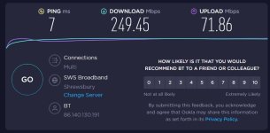

I'm on BT's Full Fibre 500 service.

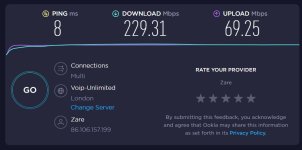

These are the results of a quick speedtest on Ookla:-

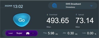

This is what I'm getting at the router (the network is not entirely idle at the moment as my daughter is on her laptop and phone.
249 down on a 500Mbps service isn’t good to begin with
It's because the test was using Wi-Fi in another room. I'll run a test using ethernet and post the results here in a few minutes.

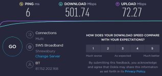

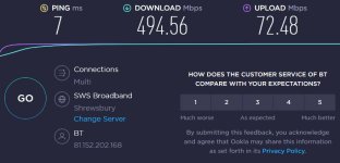

Here's the results of connecting via Ethernet:-

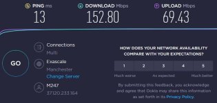

You need to take the 50%+ reduction in speed into account

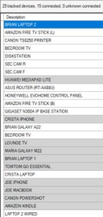

When all the family is here, we potentially have the following devices connected (see uploaded image). At busy times it's usually a mixture of surfing/streaming YouTube videos on my son's and daughter's devices and I might be surfing on my laptop or watching videos stored on my NAS, streamed to my Fire TV. There could be some downloading/uploading taking place as well, but that is very intermiitent.
So. given that the VPN is slowing things down quite a lot, I presume it would be better to stick with Quad9 for general security and only use the VPN for really sensitive stuff, like online banking?
