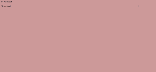

I have a RT-AX86U_Pro, recently upgraded to Skynet 7.5.8 and have been having UI issues for Merlins firewall Skynet tab. Not a super big issue as everything else seems to be running as intended, but would be nice to have working.

[*] Local File Missing - [ chart.js chartjs-plugin-zoom.js hammerjs.js skynet.asp ]
[*] Mounted File Missing - [ chart.js chartjs-plugin-zoom.js hammerjs.js skynet.asp ]
