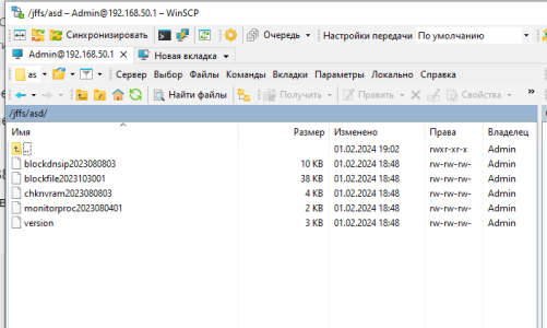

That sounds like it might be overly aggressive behaviour of Asus' security daemon, asd. If you look in the /jffs/asd directory does it look like it was updated recently? But if that was the case then I would expect it to be deleting other user scripts as well.
If you're using stock firmware then this behaviour is probably to be expected.
Clean firmware 388.6 without custom scripts
Yes, asd is wiping the firewall file seconds after download. Might be time for @Adamm to move it under /jffs/addons.
