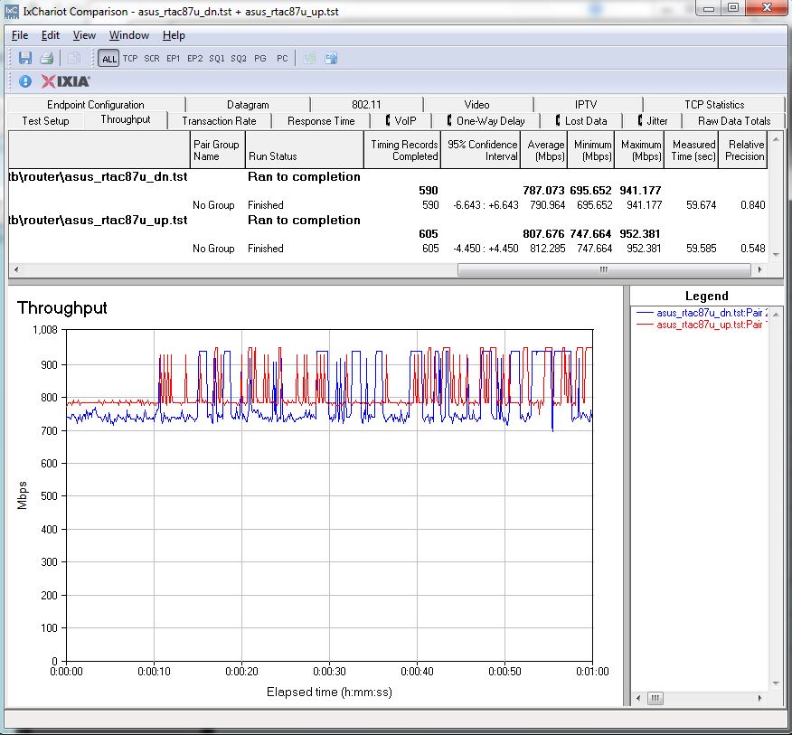

I should note that I get full gigabit speed on my local network. The drop in speed is only for internet access.
Do not use 'MAC Clone': empty the space
Disable 'Jumbo Frame'
