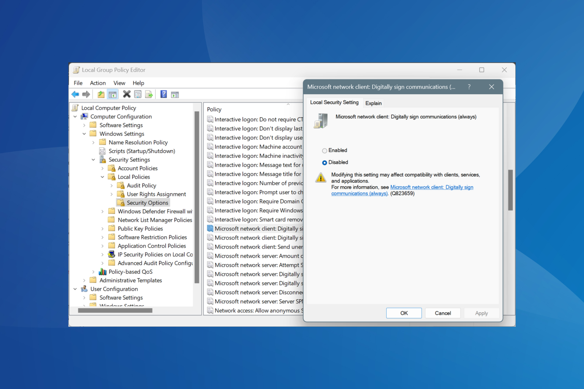

With Windows 11 there are some additional tweaks one may need to make if they're having SMB issues. Microsoft made changes that causes problems accessing network Shares. See the following:
It's possible making the tweaks may help access at SMBv2 or higher if the network device supports it.
