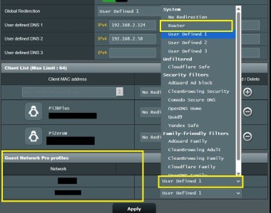

Isn't that something easily accomplished by using DNS Director and pointing the Guest Network Pro profiles to the router?
Doing something similar for my Guest Network Pro Profiles by pointing them to a local network PiHole.
That’s an option, but then the guest network clients can’t resolve local names from the guest network if that’s even a requirement on guest networks.
My point was intended to be that adding the same Diversion blocklists to every guest instance could stress the memory utilization of the router if not done smartly.
Would that (guest network client names) be solved by manually assigning host names, IP addresses, to the Guest Network Pro clients? Or by using a /jffs/scripts/dnsmasq-x.conf.add file to do the same? (or a dnsmasq-sdn.postconf file)
PS: My Pi-Hole properly uses the Guest Network Pro client names used by a /jffs/scripts/dnsmasq-x.conf.add file.
If you use DNS Director to bypass the guest network dnsmasq completely, then no, the manual assignments or dnsmasq-x.conf.add files won't matter at all.
