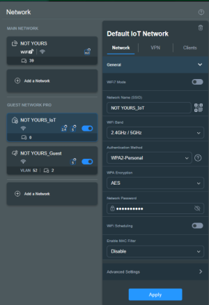

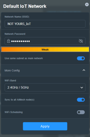

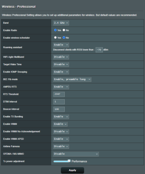

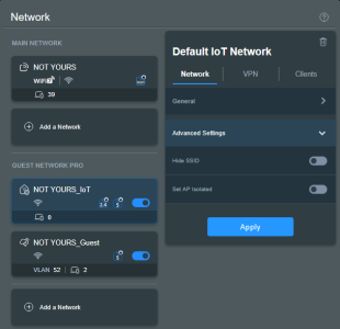

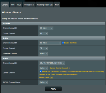

Hello Bennor,
Thank you for the quick response. Attached are the requested screenshots of my Guest Network Pro and wireless settings. DNS Director is set to disabled. Also:
I am not blocking Google's DNS servers (8.8.8.8, 8.8.4.4)
I am not running any addon scripts and no VPN connection. I am using a DNS resolver (Pi-Hhole); however I set it to "disable blocking" under DNS Control while setting up and troubleshooting.
I have all the "Adaptive QoS" settings set to "OFF"and AiProtection set to "OFF". All other options are set to there defaults besides manually assigning IP's to each device and selecting each wireless channel bandwith and control channel.
