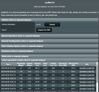

As I have one of the slowest, worst internet connections on mother Earth, I've spotted a (rare) issue in spdMerlin, which should never appear to any modern internet connection user, hoping someone could fix it!
Obviously, it is caused by Speedtest auto converting measurement units in test result summaries. The following attachment summarizes the whole issue...

Note: The bug is still present in the latest version (4.4.9) and here's an updated screenshot of the bug for confirmation purposes. Additionally, here's the link of the latest speed test shown in the below screenshot.

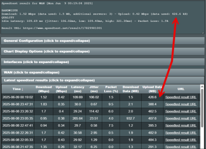

Can you confirm or deny if the actual results from a speedtest show correctly after a speedtest completes?
Absolutely! Here's the screenshot you just requested with the result URL too...
EDIT: Replaced the screenshot to include the results table after the speed test too.

@ExtremeFiretop I replaced the screenshot in my previous post as it should be more useful for pinpointing the bug. I believe you've already seen the previous one; so I felt the need to make sure that you noticed the change. This is the reason behind this reply.

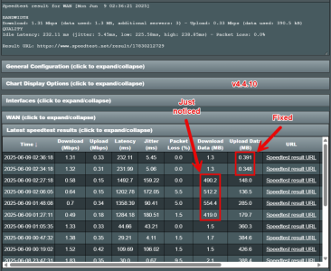

@Tarek Yag
Please run:
sh /jffs/scripts/spdmerlin develop
And test again, thanks!
Hurray, this solved the bug perfectly, thank you!
Oops, but I didn't notice any time earlier that the bug is present for Download Data too!!
Here's your screenshot for the perfect fix! I just want you to make sure that the fix is applied to the downloaded data too. It's not usual for my internet to go below 1 Mbps!!!! But it's happening frequently nowadays. And it has happened today!
We're hoping that rebuilding Syria now -after finally getting our freedom- get us newly introduced Fiber Optic Internet to everyone!
Yes the fix will be applied to both. Thanks for reporting!

Martinski saw your message and dressed up the fix nice and pretty for you over my rough draft.
You shouldn't have to monitor for long... Keep your eyes open for a new release very very soon.
