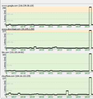

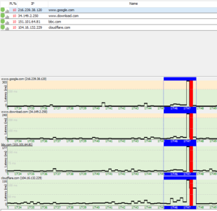

I've been auto-monitoring latency and packet loss for many hours today and although most of the day has been OK, there was one brief incident of high latency and one of 10% packet loss. I'm wondering if use of our microwave oven in an adjacent room could have been the cause of the packet loss, although it only lasted for about 15 seconds. Unfortunately, I can't be exactly sure about the precise time that the microwave was running, but I do know it was on for several minutes, so that does seem to suggest to me that it wasn't cause by that.

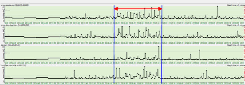

Start a continuous ping. Then put a glass of water in the microwave and turn on the microwave. If you are dropping packets, clean the microwave seals. Then repeat the test. If still dropping packets, replace the microwave for your safety.
I just carried out a 1-minute test using the microwave. Although no packets were dropped during the test, you can see that it is having some effect on the ping times.
Unfortunately that will happen even with a brand new high end microwave. RF always leaks a bit no matter how well they seal them. Cordless phones, baby monitors, bluetooth, lots of things interfere with 2.4ghz. This is 100% normal. Heck even before there were 100 neighbors using it, those things would interfere.
You're basically worrying about normal behavior of wireless. Even 5ghz will have interference and latency fluctuations from time to time. This is why hardcore gamers are always hard wired.
Could have been any number of about 50 different things. I would stop worrying about it. If auto is working well for you, stop trying to find an issue. Wireless will fluctuate and have interference, it is the nature of the beast.
A new microwave probably won't be much better. It doesn't take much interference to mess with wifi and every microwave no matter how good will leak a bit of 2.4. Out of the 1000+ watts a bit is going to escape no matter what.

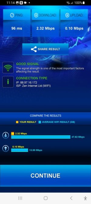

And this was a speed test I took a few minutes ago when connected to channel 11.
