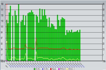

OK, I'm now mildly optimistic! Earlier this evening I set the 2.4 GHz band to "N only" and since then, although the speeds have dropped a bit (no issue at all for the half a dozen devices I have that use that band), they are much more consistent (see latest results - you can clearly see where changed the setting). In the last half an hour, I have reinstalled the latest Merlin build and used the last configuration file I saved from that build. I just had to reset the 2.4 GHz band to "N only" and manually set the Wi-Fi channels to use 1 & 44 (the latter seems to give the best results on the 5 GHz band). I've also set the USB flash drive to use 2.0 mode, although I'm still not sure it was causing any problems when set to 3.0 mode, but it doesn't need to be on 3.0, so best to be safe than sorry. Incidentally, as others have commented, the Samsung flash drive was getting really hot, so I have added a small extension to it, which has solved the problem. I've used one of these: https://www.amazon.co.uk/dp/B09Q8ZDP5F/?tag=smallncom-21
I've leave the monitoring on overnight and review the situation in the morning.

Well. my optimism was short lived. When I came down this morning I saw that all had been well over the night time period, thus:
But now look what's happening (and I'm still on channel 1, with very little other traffic on that channel):
So it appears to be you. What bluetooth device do you turn on/use when you get up, do you power up your mobile in the morning, etc?
Remember, inSSIDer is just showing you wifi networks. Not spectrum use/interference.
I've found the answer to the latest "interference". I'd forgotten that my laptop (where I'm running the test from) does an automatic disk image backup to my NAS each morning. I've just tested it again using my ISP's router and got the same result. So, ignoring the last post, it seems like setting the Wi-Fi to use N only is the solution to this particular problem. A big thank you to you and everyone else for assisting me with this.
