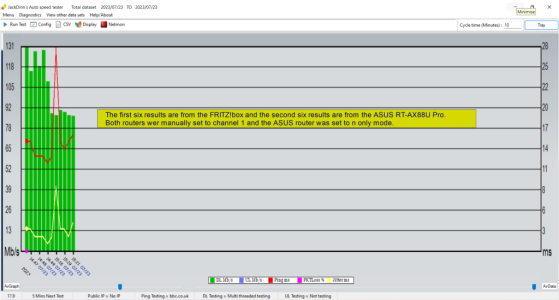

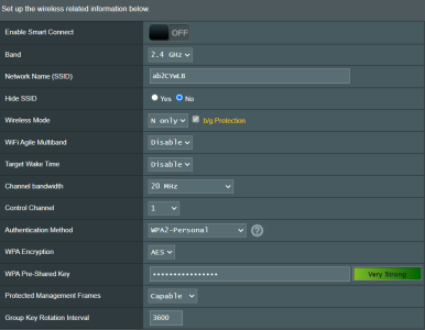

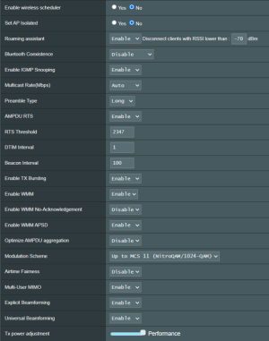

Interesting variability in the AX88U Pro 2.4 GHz signal strength. Can you post the "Wireless/Professional" settings for the 2.4 GHz band?
Here you go.
On the 2.4 GHz and 5 GHz bands, try disabling:
- Roaming Assist
- Multi-User MIMO
I'll try it in the morning when the network is quiet. What effect will making these changes have on my network?
Those will likely have no impact. However disabling universal beamforming (I'm sure it's been mentioned in this thread before, in fact this is mention #3 by me) will likely stabilize your 2.4ghz signal strength.

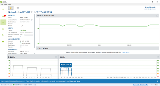

Just to confirm, it seems to be OK now on channel 1, even with AX enabled. The 10-minute blips are caused by the JDast tester running a download speed test, so nothing to worry about.

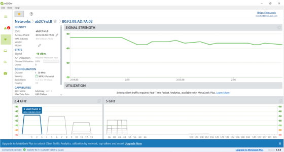

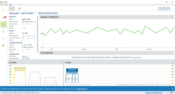

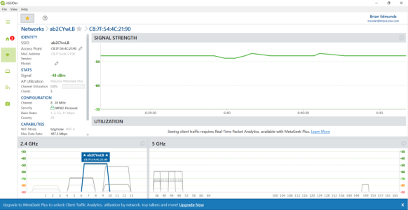

Hmm - I just tried to use my Canon scanner and received the error message I was getting before, so I checked out the Wi-Fi and sure enough, the data transfer speed had dropped right down again. At the time, I had it manually set to channel 1, so I've set it back to auto and its chosen channel 8, which is working OK at the moment. What I can't understand it why it was having problems with channel 1 when there was very little traffic on that channel as you can see below:
This was the information being reported by InSSIDer about my Wi-Fi (ab2CYwLB) when I was on channel 1:

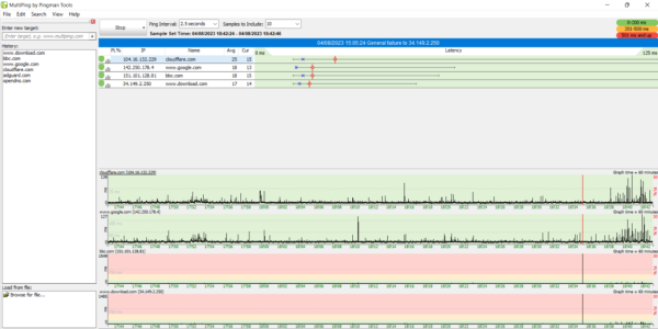

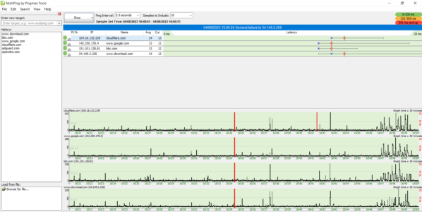

I've turned on automatic ping monitoring and will leave that running for a few days to see what happens. I'll leave the router set to auto as well, to see what it does.
Current Wi-Fi signal strength (auto channel 8 and with Universal Beamforming disabled) and ping results over the last hour. The signal strength is more stable at the moment, but I'm not sure if that is because of the channel change or turning UB off (I suspect the latter, based on comments I've read in this thread).

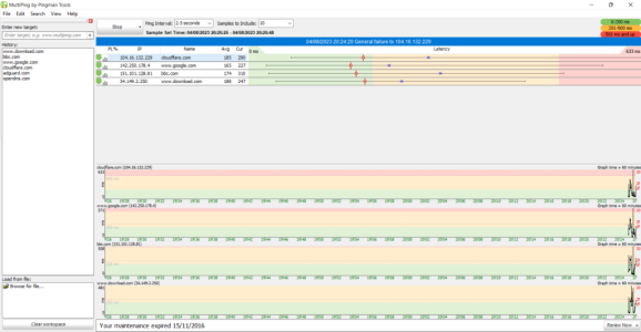

The ping interval has shot up again. I've tried changing channels from auto (8) to manual and both give similar results. So now I can't seem to rely on anything to give good results and all this with little traffic from my neighbours at the moment. The data transfer rates are also rubbish now as well (1.61 Mbps down and 2.07 Mbps up).
I just swapped out my ASUS router for my ISP-supplied router (FRITZ!Box 7530 AX) and got similar abysmal results about 10 feet away from the router, Viz, with a strong Wi-Fi signal the download speed was 3.01 Mbps and the upload speed was 1.59 Mbps on a full fibre 900 connection.
I've put the ASUS router back in service and it's chosen channel 8 again. I've set the router to "n only" as tried previously and the speeds are now 30.82/20.94. The current ping results are as follows:
