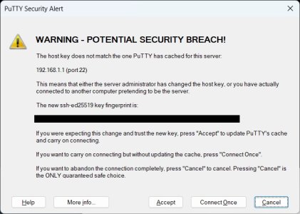

No issues with using the latest version of Putty (0.82) to access two separate RT-AC68U's, one running latest Asus stock the other running latest Asus-Merlin:
RT-AC68U - 3.0.0.4.386_51722
RT-AC68U - 386.14_2
As a troubleshooting step if you haven't done so already, remove the saved entry (if there is one) for the router and recreate it using Putty's default values. Or disable SSH in the router GUI, reboot the router, then reenable it as a troubleshooting step.
Got the usual Putty Security Alert at first connect to both due to the host key being incorrect (reset both routers in the past). Example alert attached (I hit the Accept button on the alert).

What firmware version are you running on the router?
RT-AC68U - 386.14_2
