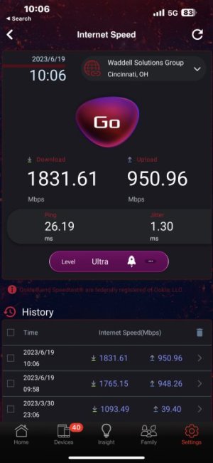

I switch from spectrum 1gb cable internet to Alta 2gb fiber. I was getting about 700mbps on wifi while with spectrum. with spectrum I would run a speed test on the router and get 1029mbps. I do a speed test from the router and get 1800 to 2000 mbps on alta.

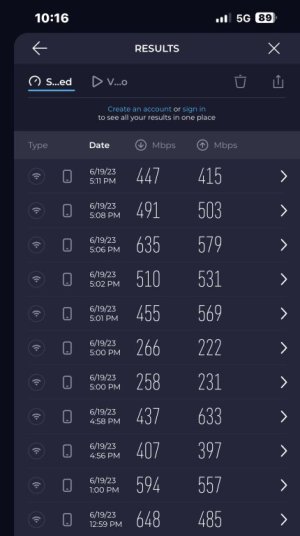

When I run a speed test on my iphone with alta I get 640 and under.
Use anything else but a mobile device to test WiFi speeds with (preferably, when it is plugged into AC power and on Max performance mode).
I have ipad pros? would that work? My wife has a laptop but I'm not sure how good the laptop is. It was cheapish at microcenter. I don't have access to the laptop right now
everything else is wired in the house except for 1 samsung tablet, 4 Ipad pros, 6 phones and the house camera's
