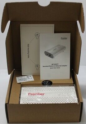

It depends on what you’re getting for that $30. Can you supply a link to the product listing?
Same as the GoCoax model but without pass-through, I think.

Yeah, they’re obviously goCoax adapters customized for Frontier, also referred to as Frontier FCA251 adapters, I believe. My main concern would be if any config customization or firmware update were ever needed.
Pretty great price; I’m tempted, myself.

Ended up buying 4. Guess I'll take a gamble on firmware updates. Took your advice and bought real MoCA splitters, 3pcs of Holland MSAT-2. Got an ANTRONIX 4-way for the main splitter. Didn't catch 70dB preferred on the filter till now, I had bought the cheapest Amazon had which is only 40dB, but hopefully it'll be good enough since I'm just using OTA.
